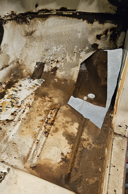

There's not a panel on the truck that doesn't have significant amounts of rust/holes/missing chunks/Flintstone floors and a seat that tries to molest anyone that sits on it . The truck was "undriveable" when we bought it (clutch just needed adjusted). So with all that in mind, Ilene was not nor will ever be a "show stopper" or "correct numbers matching" vehicle. Our goal with Ilene is to get her on the road, reliable and ready to do pickup stuff!

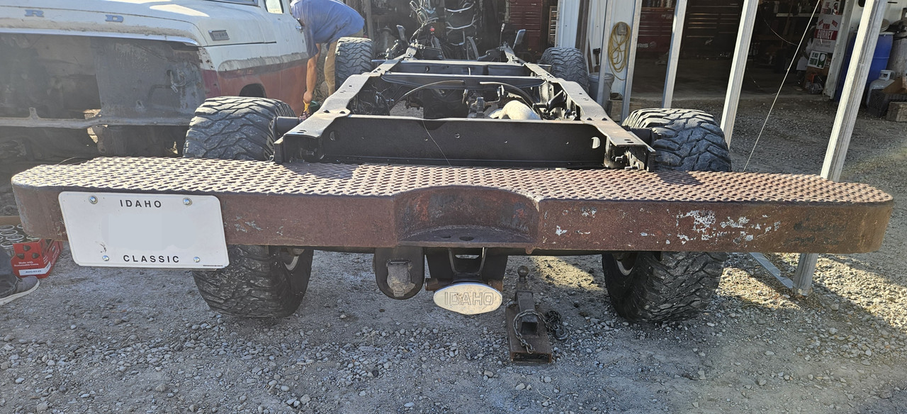

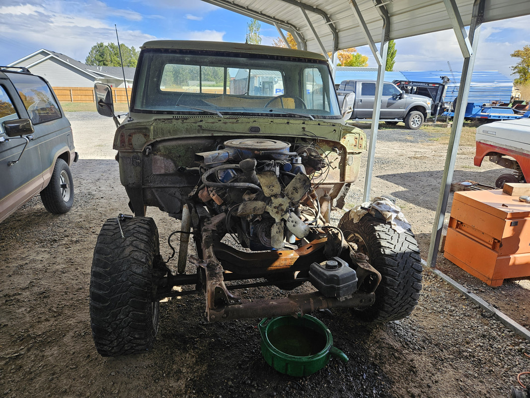

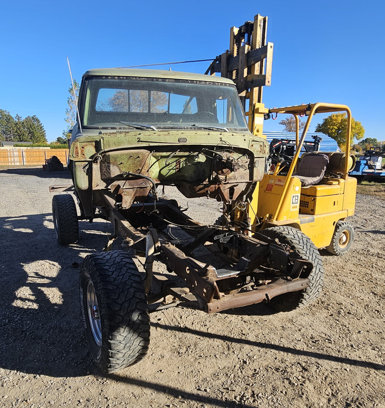

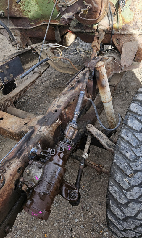

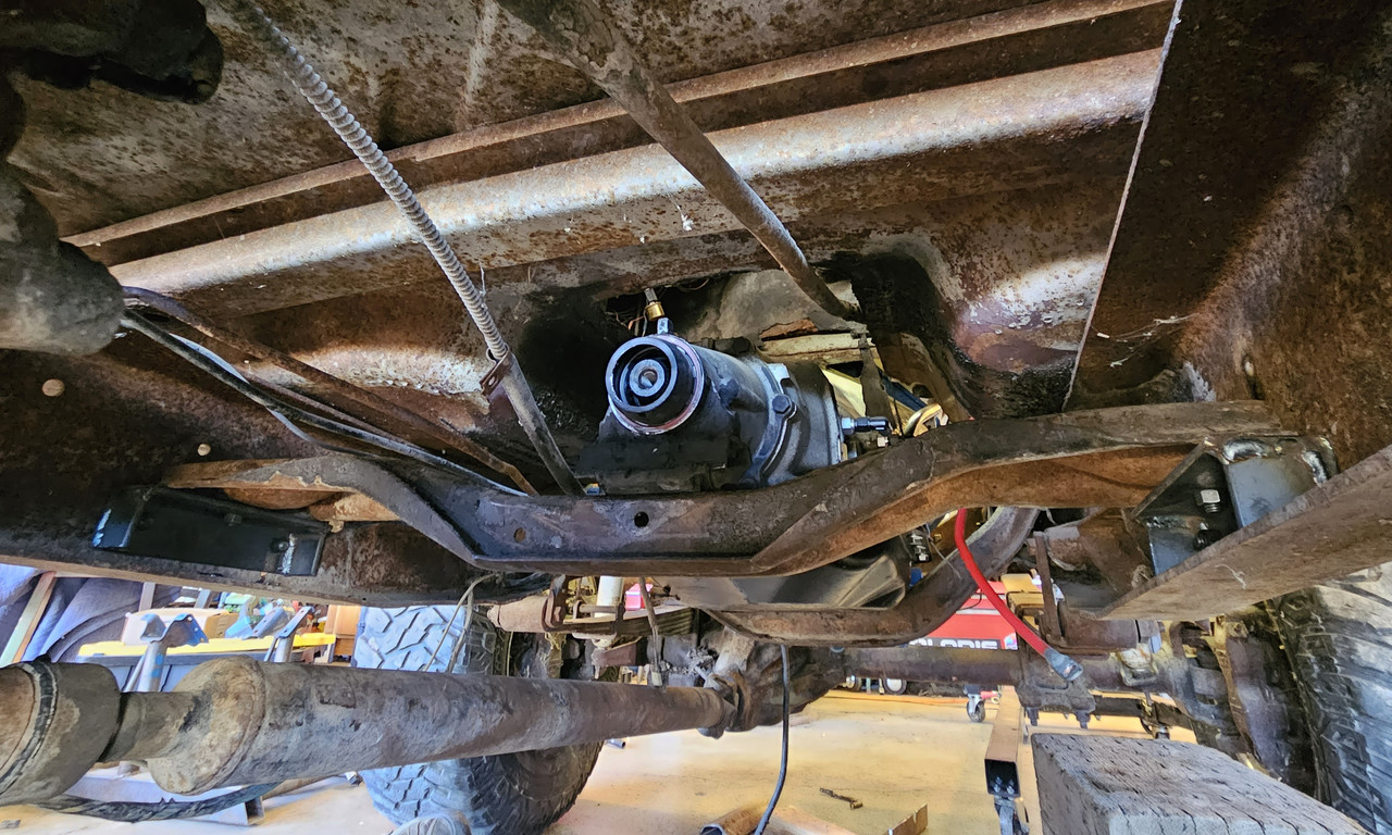

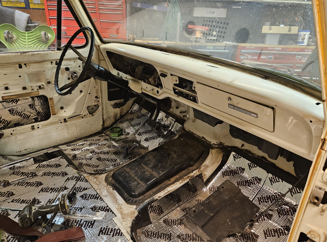

Pulled the front clip off the truck today so that I could pull the 390. With all the rust, made it quick and easy
The 390 is actually a pretty good running engine, but nothing like a modern engine.
Next up will be making new engine stands for the frame and motor mounts. Hopefully, I'll be able to swing the engine into place on Saturday.

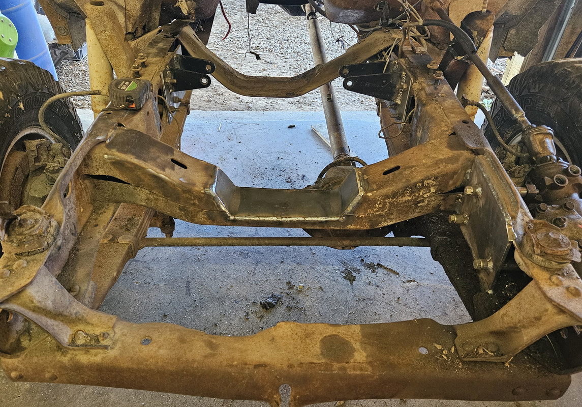

Ilene update:

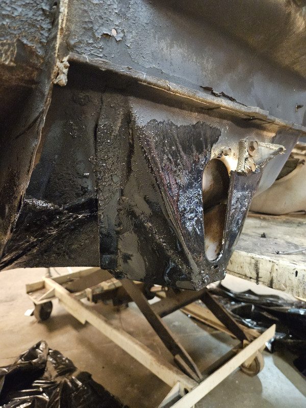

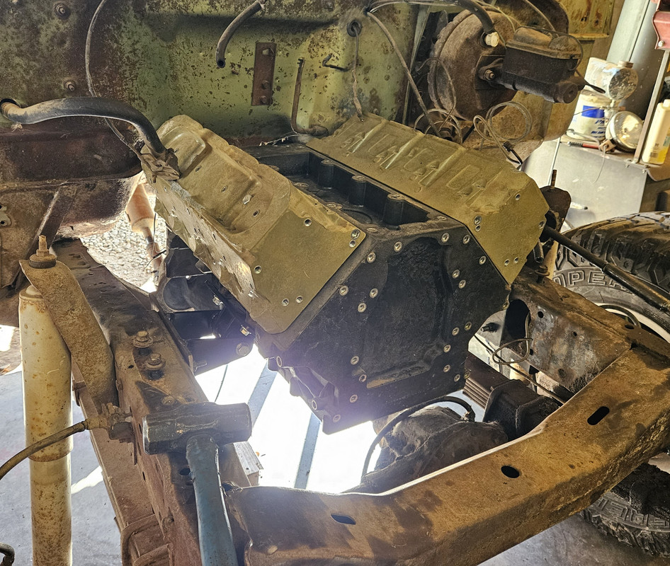

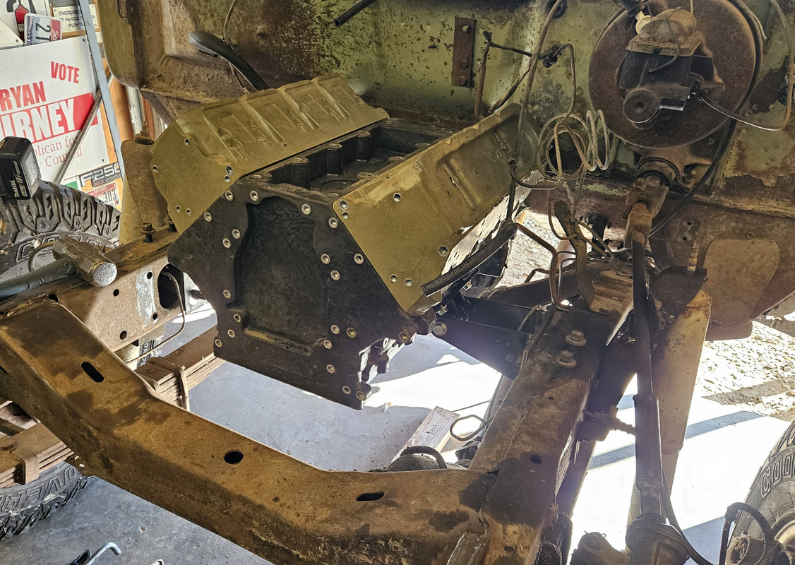

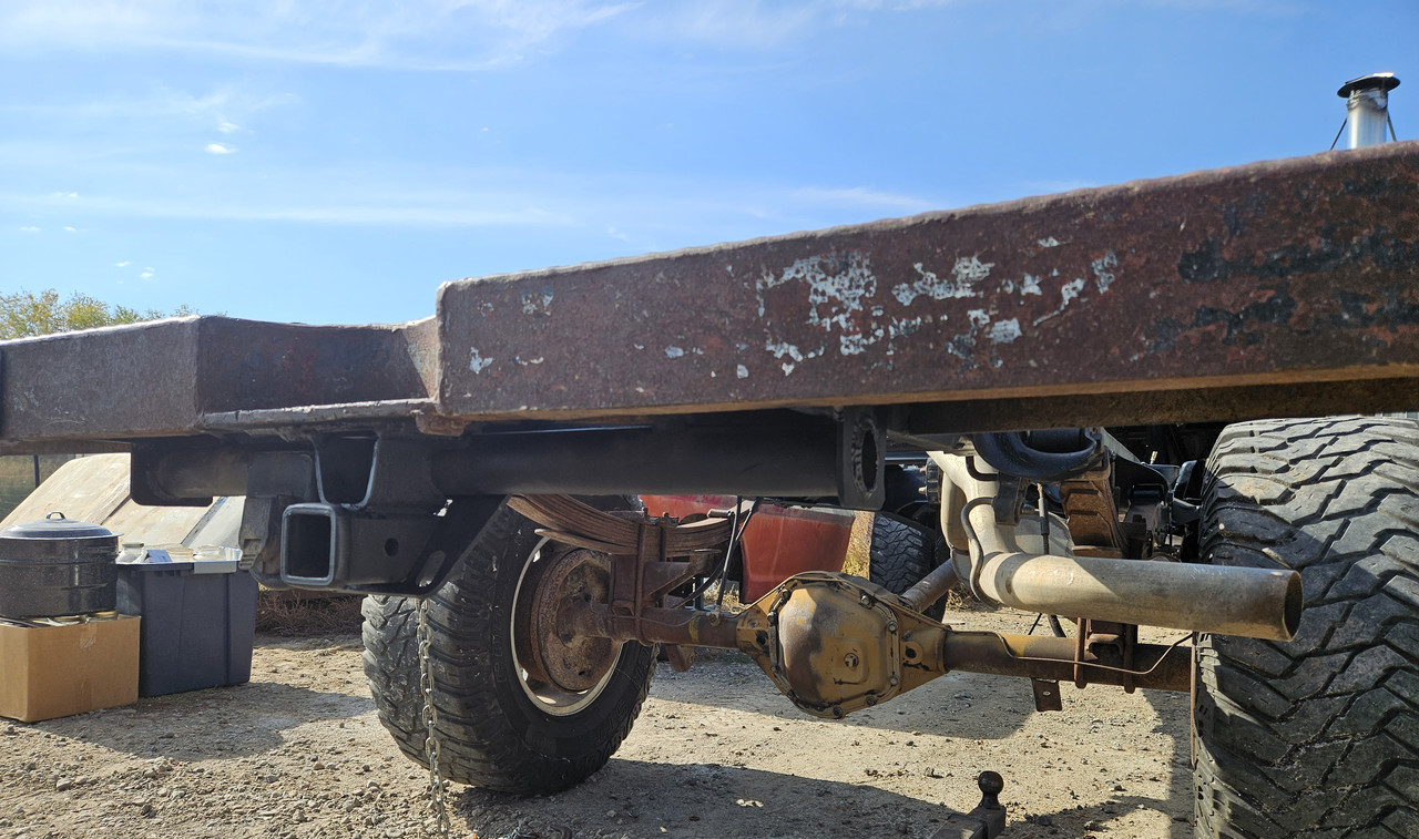

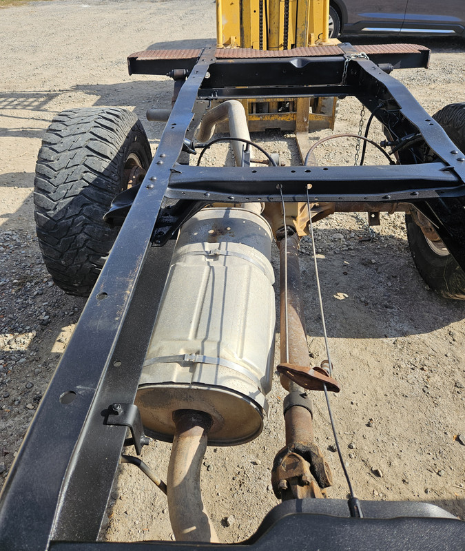

Today I was able to get the engine and Transmission mounted. I have a foam block mockup engine with a bellhousing off a 4L60E. This combo makes fitting up and adjusting things much simpler than in and out with the whole engine/transmission assembly.
I was able to reuse the transmission cross member, I just had to move it back and make new mounts for it.
With everything in place, I measured for the new drive line (a total length of 15") and then pulled it all out. I had to notch the front cross member, so I bent up a new piece of 1/4x4 plate and burned it in to securely put it all back together.
Finished up the day pulling the junk cab so that tomorrow I can get the frame cleaned and finish up the fab work on it.

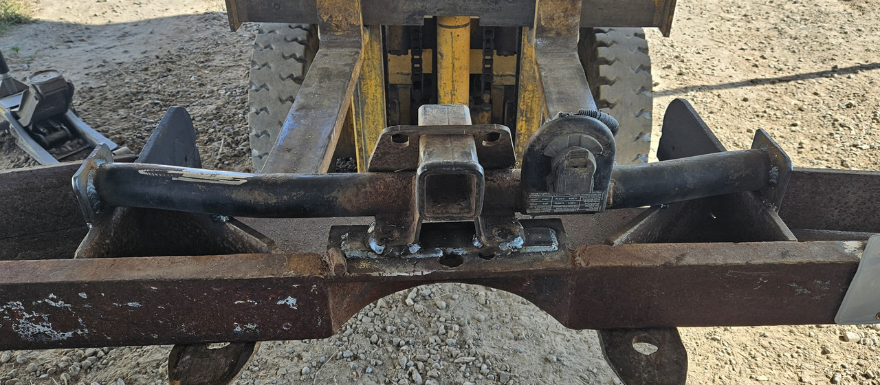

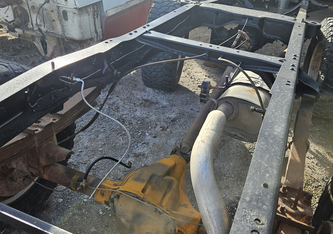

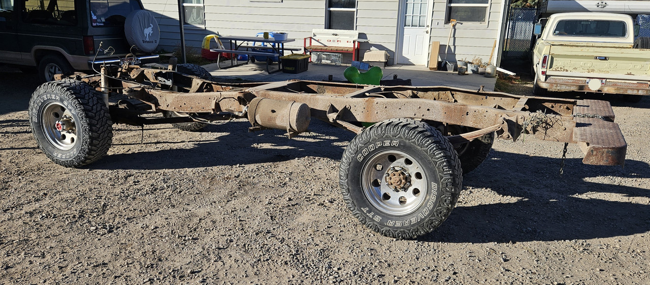

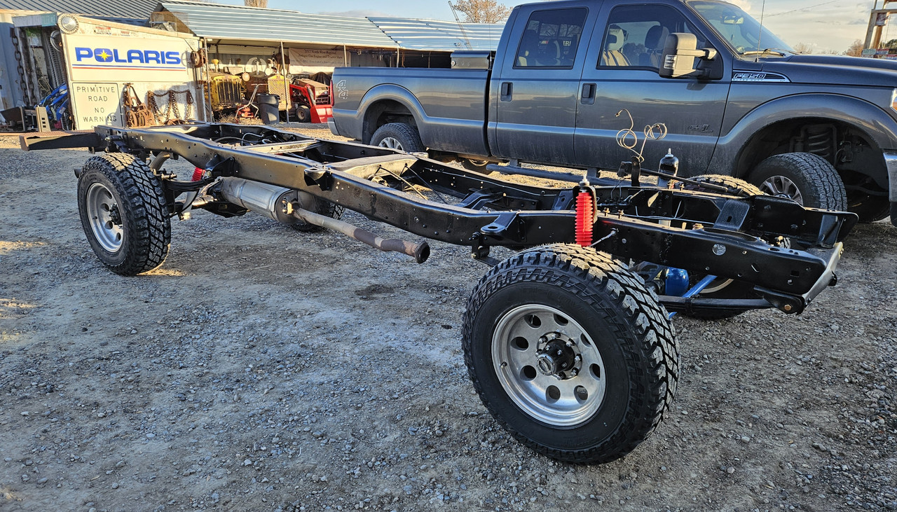

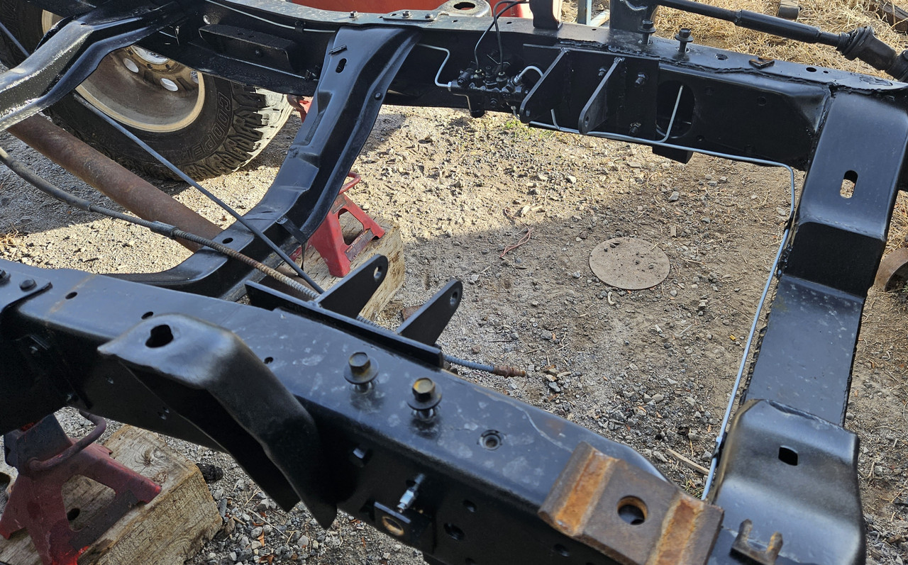

Ilene update ('68 F250 4x4): Today was frame day! The frame was degreased, sandblasted, rust sealed and painted. The wet sandblaster makes quick work of rust... it just flash rust really quickly, so the metal needs coated and painted as soon as its dry. There's still some welding that needs done on the frame to fix a few things, but that can be easily touched up after it's been repaired.
Next up will be pulling the axles one by one and rebuilding/adding TracLok to them. Hopefully, by the time I'm done with that, new springs will be here!

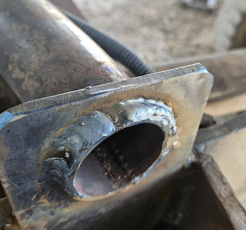

Didn't get as much done on Ilene today as there was a Scout II in the shop. I did manage to hang the muffler and tail pipe and Integrate a receiver hitch into the bumper. I started out planning to build a separate set of mounts for the reciever, but since the bumper is made of 1/2" plate, there really wasn't a reason not to Integrate the two together. I'm very pleased with how it turned out, and now I have a place to store my Idaho Spud.

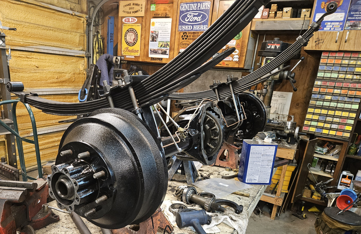

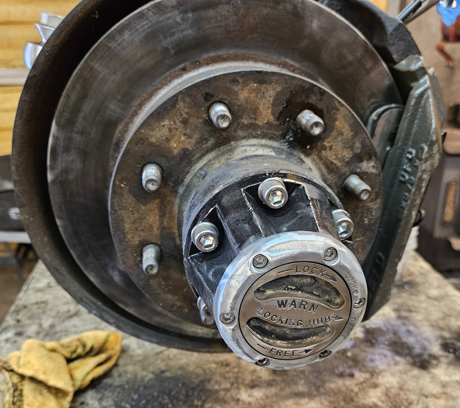

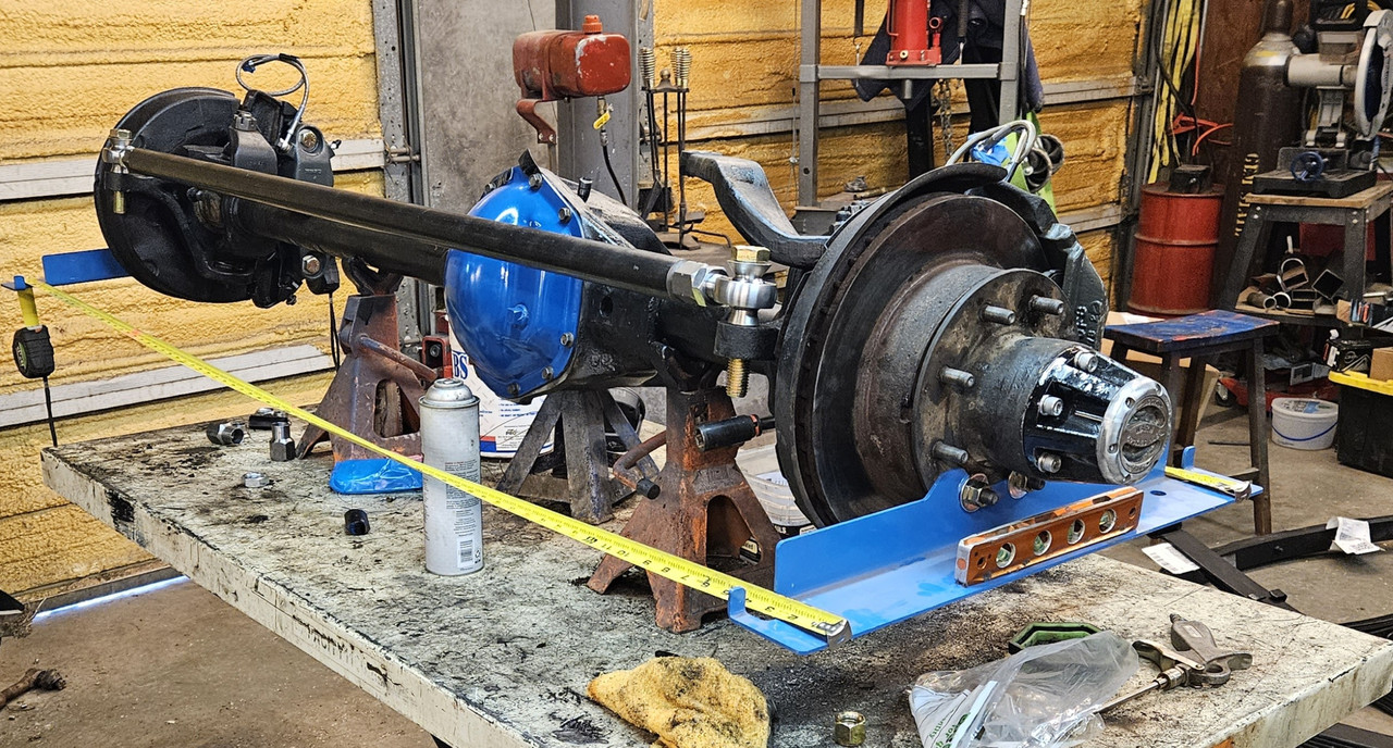

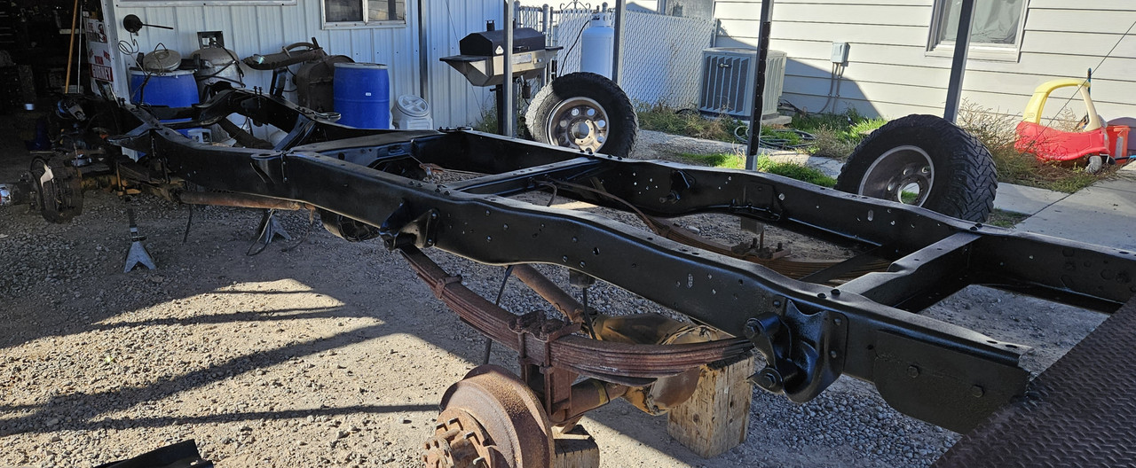

Ilene update (1968 F250 4x4): The front axle is all done (all new bearings, seals, added a TracLok limited slip), Warn Locking Hubs, brake calipers and I fabricated up a new tie rod. Used my TMI alignment plates to set it square, then built the tie rod.
Finished up running all new brake lines on the frame.
Hopefully, I'll have U bolts in the morning so that I can hang the new springs and the rebuilt axle... then hopefully I can pull the rear axle and start on it before going back to work.
Once the rear axle is done, I can put the new powertrain back in and start on the body work, which fortunately is too expensive.

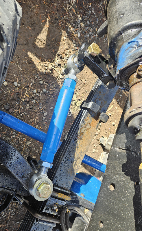

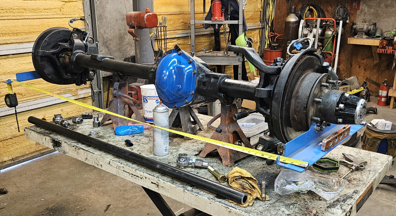

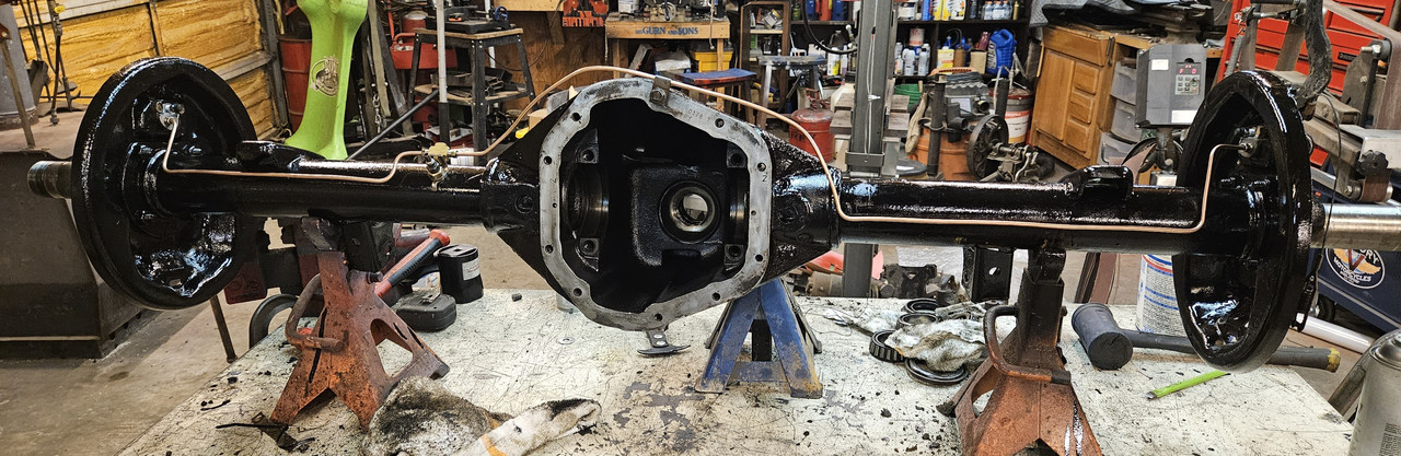

Ilene Update: The front axle and new springs all installed.

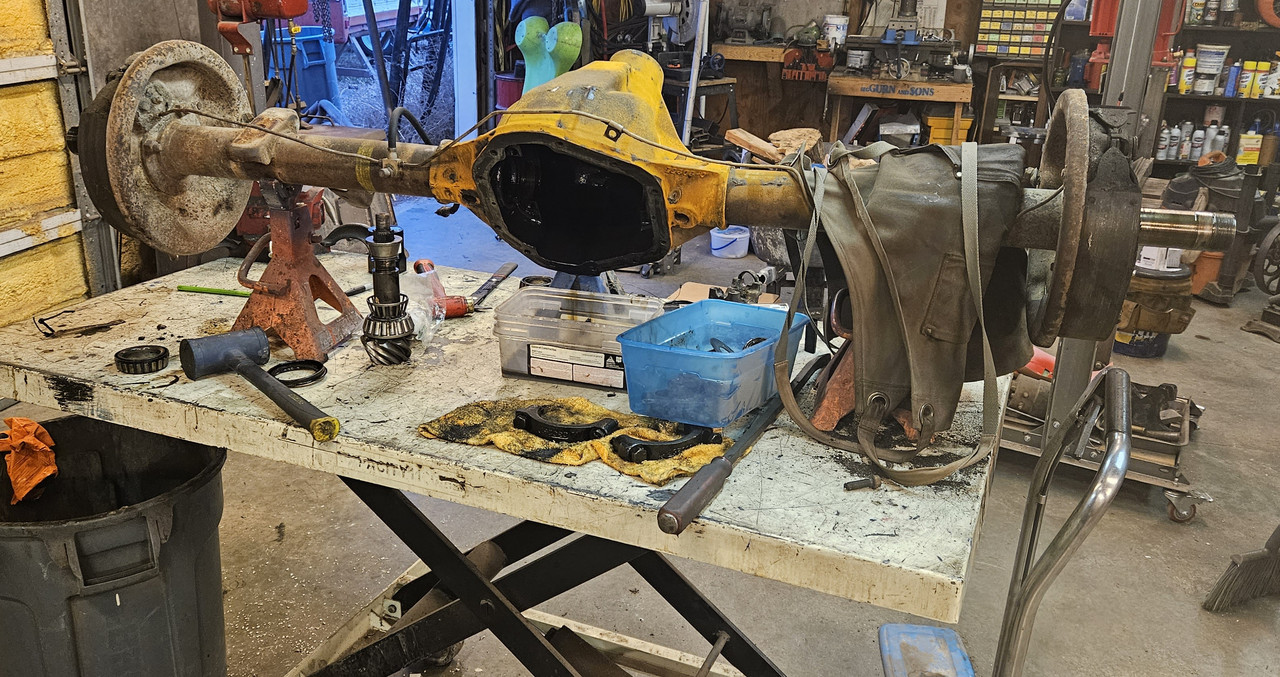

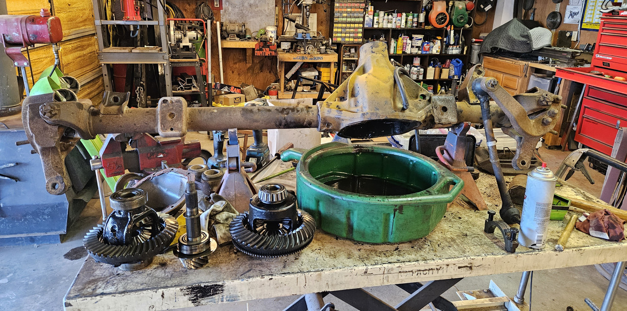

The rear axle is all disassembled and on the bench waiting for parts and me to have another day off to work on it.

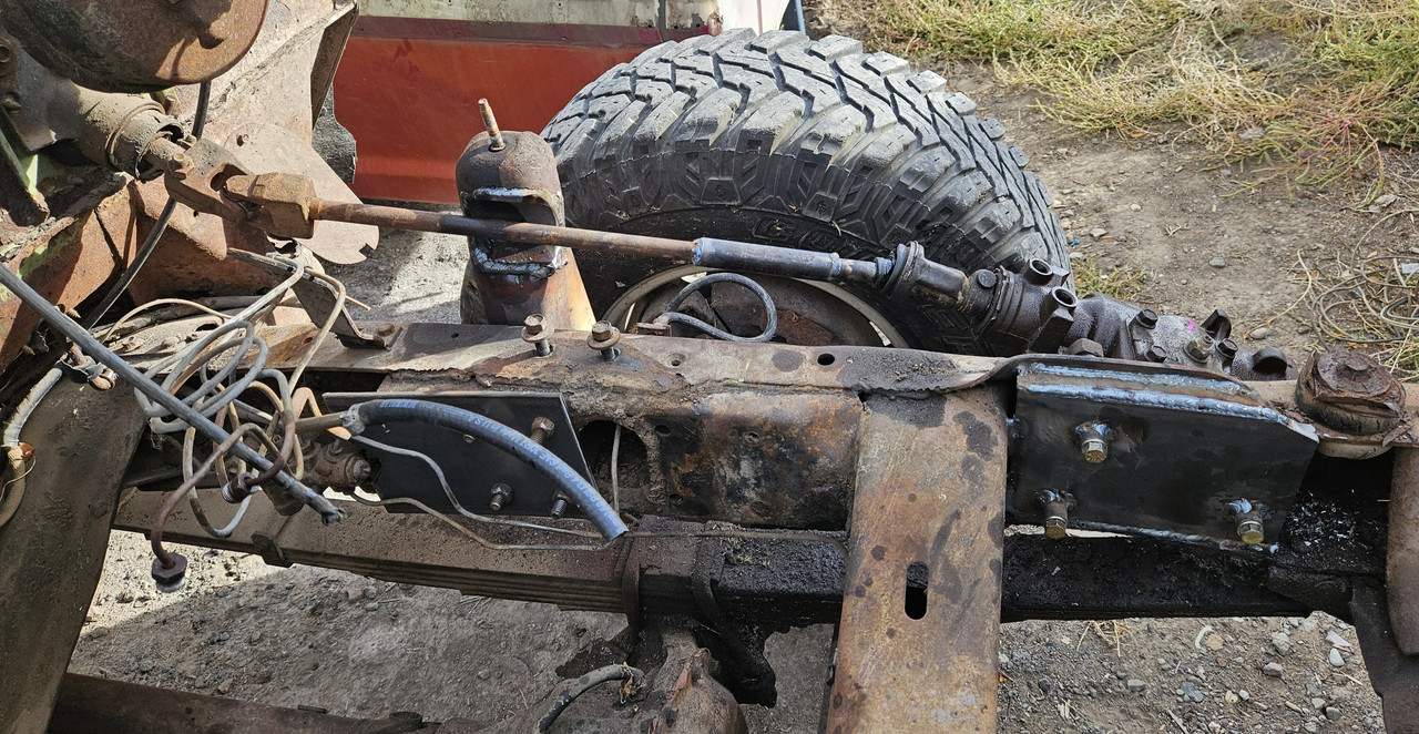

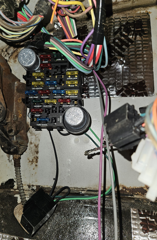

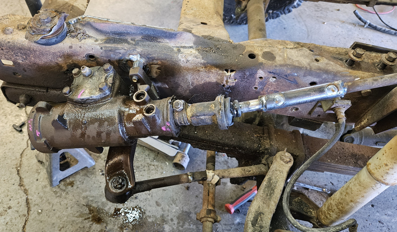

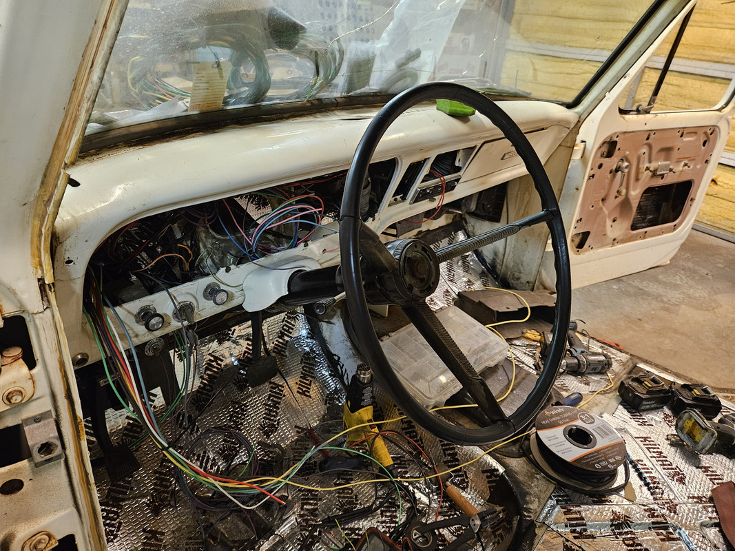

I'm eagerly watching this since I'm (hopefully) going to be installing that same steering box and front axle on my 71 in the next week or two, would you mind posting up the approximate drag link length you wound up with?

I cut down and modified the original pitman arm so that I didn't have to worry about interference with the tires when turning full right. I made a couple pieces that are angled to allow the drag link to sit level. Welded them to the pitman, then used the lower one a a drill guide to drill through. It all works beautifully. I'll be running a 33"ish tire, so I'll have lots of clearance (I'm mocking up with 35" tires, that don't clear the fenders).
Wrapped up my day today by painting the rear axle (waiting on parts still) and installing the new wheel cylinders and hard lines.
photo url
photo url

Ilene Update (1968 F250 4x4): it only took three weeks to rebuild the rear axle (waiting and waiting on parts) but the truck is back on all fours with a new set of shoes (Cooper Discoverer S/T in a 255/80R17 which is a 33x10). Monday we'll get the cab in the shop and maybe even put the powertrain back in the frame!

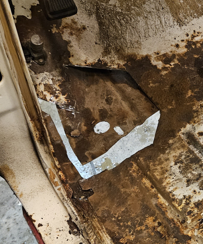

This week I was able to get the rusted spots cut out of the floor and patches welded in. While welding on the cab, I also repaired the passenger side cab mount. Applied POR15 to all the surfaces, then installed Kilmat. Painted up and rebuilt the steering column and the interior door panels. Today, I pulled the cracked up dash pad and the faux wood trim. Next up, we'll start on installing the new wiring harness and rebuilding the doors.

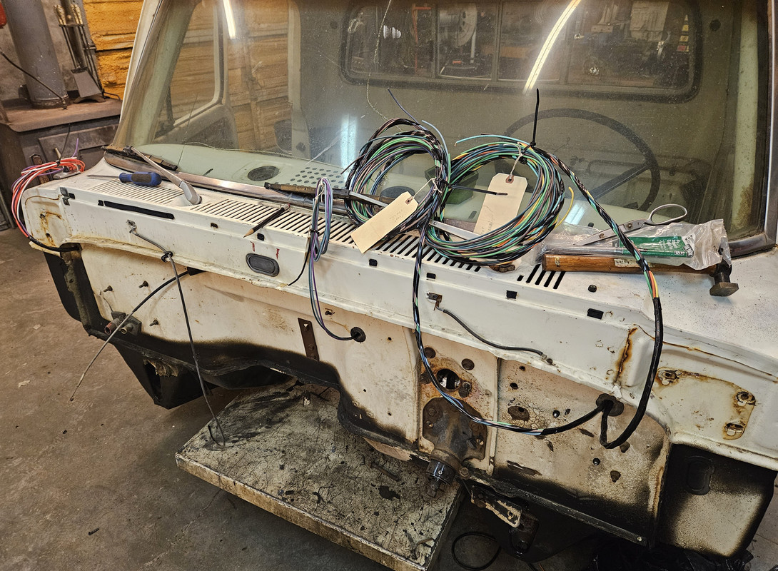

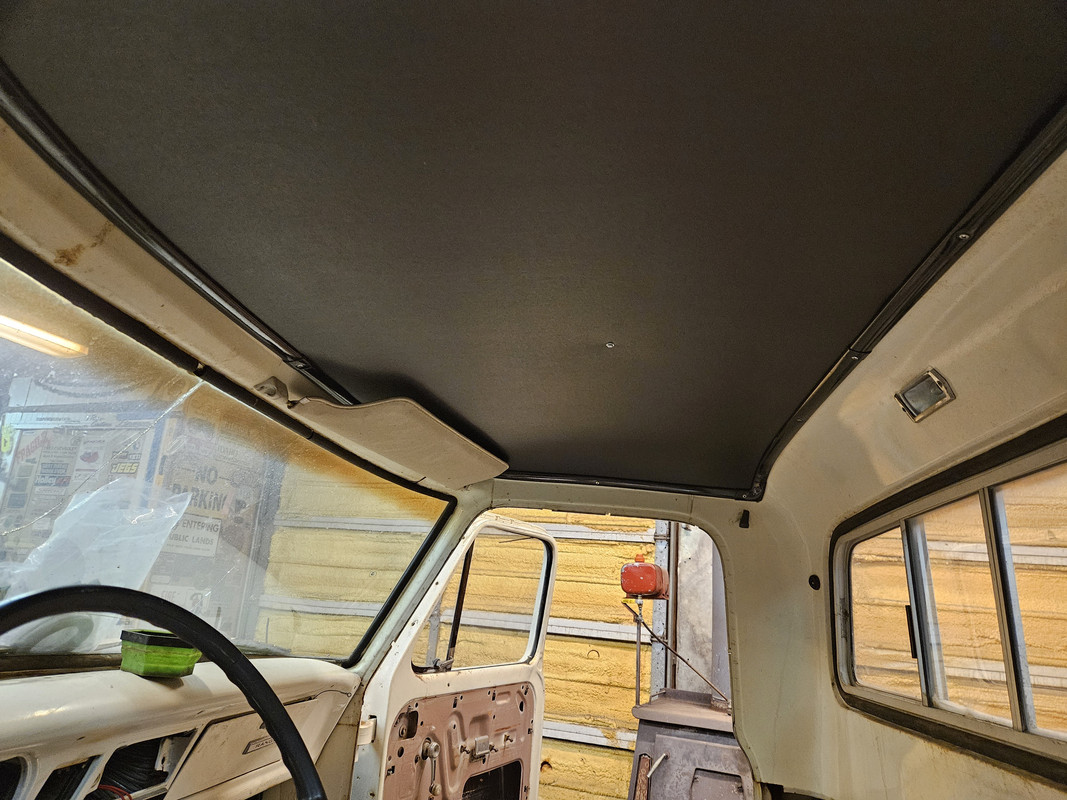

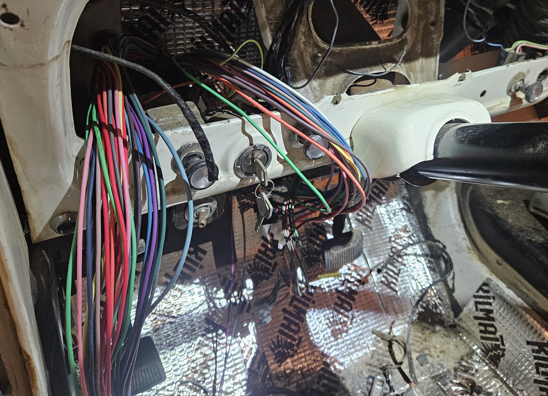

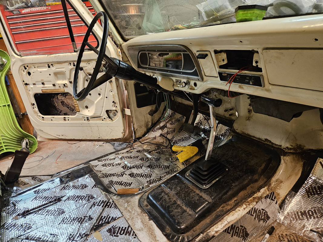

Ilene (1968 F250 4x4) Update: The last couple days I've been working on installing the new wiring harness. This is a full cab/chassis harness. Started out by splitting all the wires into separate groups (front, rear chassis, engine, instruments, accessories, cruise control etc). Then mounted the fuse panel and started running the various wiring groups out and towards their final destinations. Since I thought I had the overhead wiring done, I installed the new head liner... I was wrong, it needs to come back out .

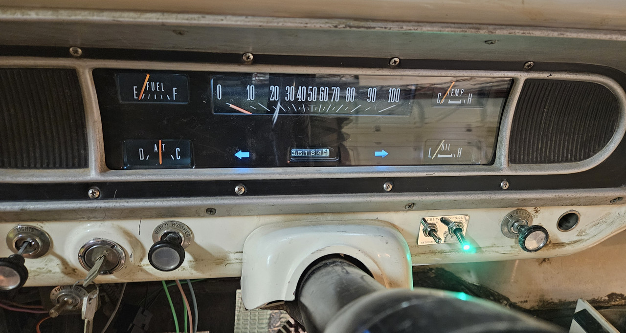

Today, I wired all the lights, gauge cluster, wipers and the rest of the interior. The cluster recieved a new lens and LED bulbs. Other than having a faulty light switch (verified by pulling a known good switch from my '70 F100), all the wiring seems to be functional. Finished up the day by installing the transmission shifter (to wire in neutral safety).
Tomorrow I'll start on rebuilding the doors, and wrapping up more of the cab work.

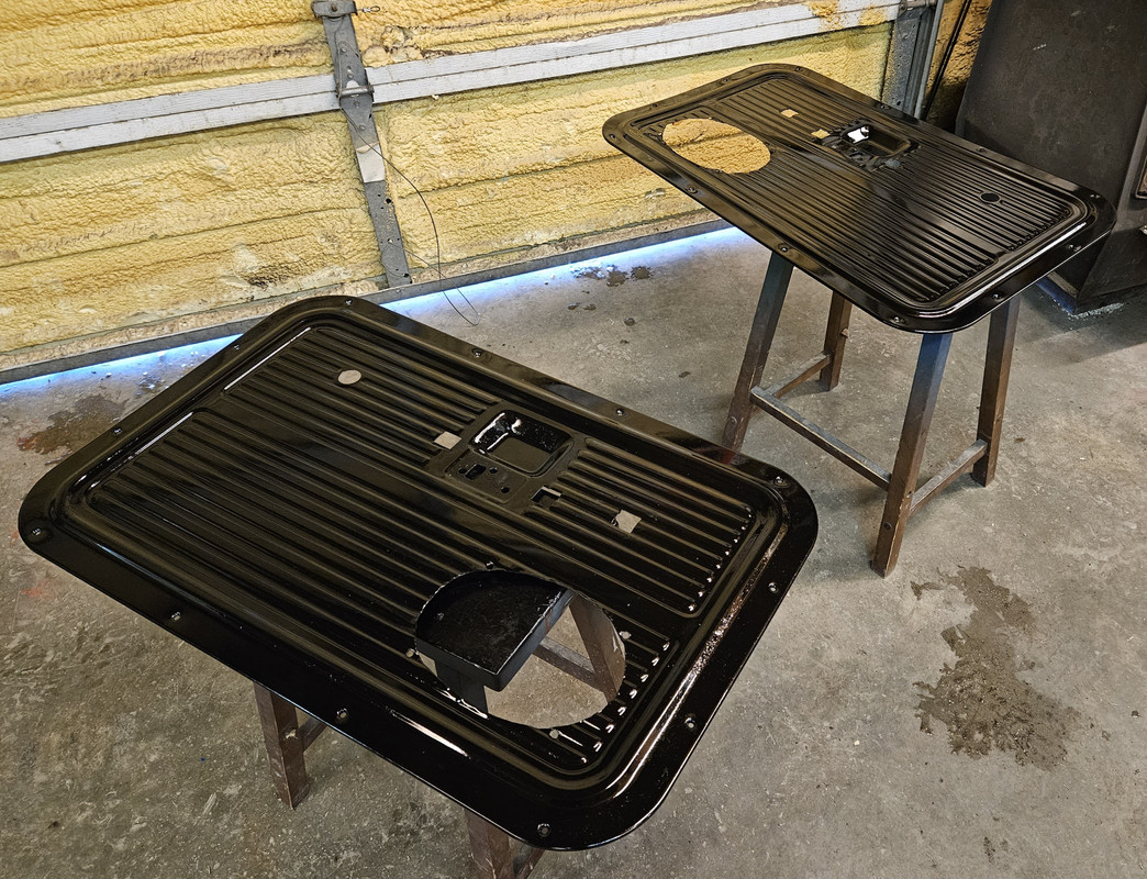

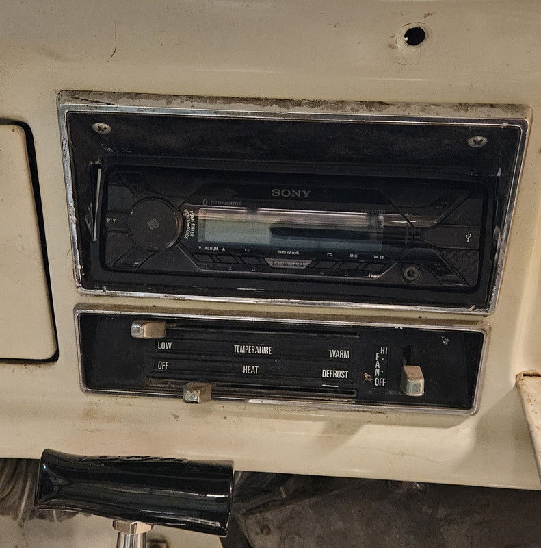

Ilene update (1968 F250 4x4): Doors and wing windows rebuilt. Speakers installed and wired. Had this Sony out of a past LS donor. The trim piece was broken, so figured I could modify it and not feel bad about it. Trimmed it up to fit in the stock radio bezel. It'll work, for now... if your curious, Ford door locks use Schlage pins in the cylinder. Keyed the doors to match the ignition with pins from my Schlage set. Made my day
